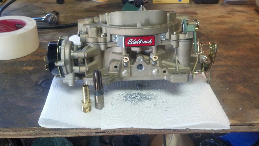

Here's my idea, I initially sweated the cost, but it made such a huge in improvement with hot starts, fuel economy, I couldn't have been happier. Edelbrock 1409, everything bolted right up , fired right up,

44Ydnar88 wrote:Here's my idea, I initially sweated the cost, but it made such a huge in improvement with hot starts, fuel economy, I couldn't have been happier. Edelbrock 1409, everything bolted right up , fired right up,
Looks like you had to drill and tap for the PCV port? Also, electric choke...Just need switched 12vdc run to it?

1/4 pipe tap, brass barbed air hose fitting. I used the 12v side of the ballast resistor,
