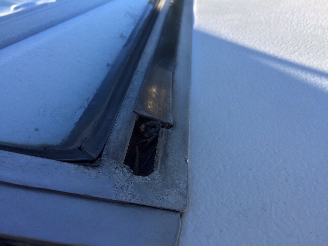

These are the windshield seals. Noticed the frames need some attention as well...... Add it to the list.
Any idea where to get this type of material?

Follow this link
http://www.taylormarine.com/hardware.html
I believe you want to look at "screw cover vinyls"
Try to place one order for everything you need, they bang you pretty good for shipping & handling

I had the same problem.I bought 3/4 flat vinyl molding from Home Depot. Painted it black and attached 1/2 foam weather striping to the Back to fit in the track. Glued it down with contact cement and looks great. I will post a picture later this week when the river goes down. Easy and didn't cost a lot.

Great suggestions, i will have to get a measurement of the gap, and figure out what strip fits best. I found a few marine window strip suppliers as well that had some similar, but need to measure. Once I find what fits, Ill get some ordered and post what I used for others to reference if needed. But also very interested in the 'make it yourself' approach. Not because I am cheap... But more to prove to my wife "I can make that". Our little joke which only rarely goes in her direction.

Update, after much searching, and some good leads, I found both types of window seals. For the flat wide trim ( screw covers) I found the perfect match on Ebay. A lady named Babbett has both 3/4" and 5/8" material that snaps right in.
For the funny shaped window trim, I found at Taylor Made. Both a bit pricy, but look great. I will finish the rest of the windows in the spring since boat is coming out soon. And I'm going to try to have the badly micro cracked corner windows replaced, and trim them out when they are put back in. Stay tuned.

Glad it helped. Been off for a while..... the seals worked great, but had some tight spots that I had to really push the rubber into. All in all the seals worked great and look great too.
