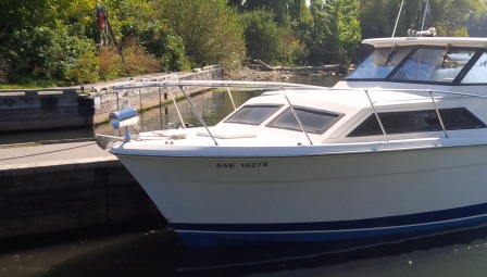

Hello again everyone . On my F25 I have metal holder for anchor lines and would like to change set up . perhaps mahogany or teak pulpit that extends cpl feet out and maybe a windlass . I have access to one for 100 $ so may take him up on offer. To do pulpit properly how far on deck should one go like lets say foot or so towards hatch with wood support from bottom deck or is that over kill ? perhaps people can share pictures from top and bottom of their installations and ideas ?
bow pulpit.jpg (46.99 KiB) Viewed 8173 times
My idea is to make opening in pulpit and slide that metal holder into it

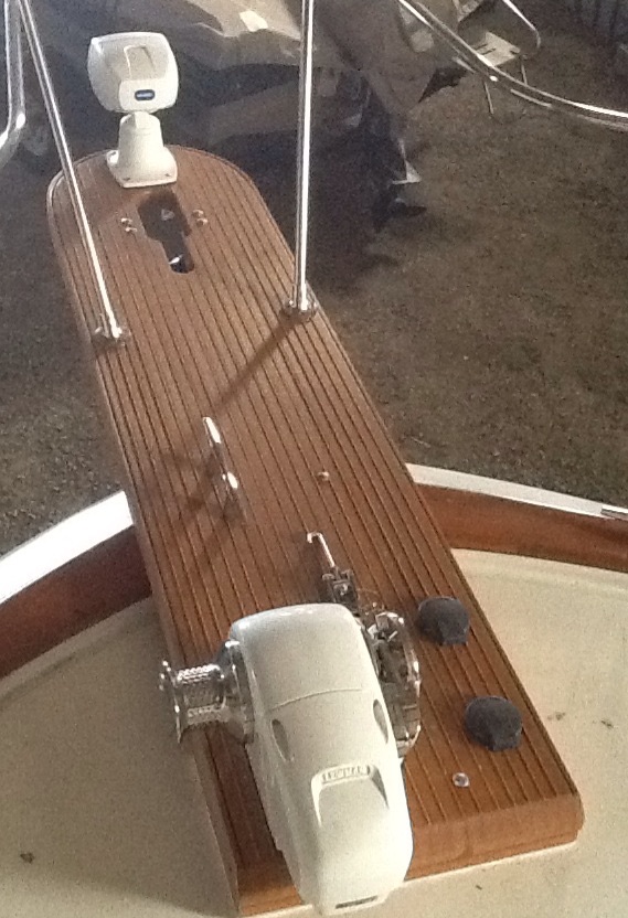

I guess my pulpit is roughly 50/50 (or maybe 60/40) in terms of over the deck vs over water. See pics in the attached link. For mounting you should be thru-bolted and have some kind of backing plate below (for when someone stands on the very front of the pulpit when you are bounding through waves ... the force on fasteners will be pretty significant). It's a bit hard to see in the pictures, but there is a wooden pad between the pulpit and toe rail, and the forward fasteners go through that. At the aft end there is another (thicker) pad and two bolts through the pulpit/pad and into the rope locker below. This leaves a gap of >1" between the pulpit and deck surface for much of it's 'over the deck' length, so water can flow freely under it and out the forward bow scupper.

My pulpit is 5' long with about 3' on the deck. It is through bolted with backing plates. The windlass has 4 studs through the deck which have backing plates. There is a total of 8 bolts/studs holding the pulpit. When you drill through the deck, make sure you over drill the holes larger and reef out the coring material. Then fill the holes with thickened epoxy and drill the holes to the proper size. When I installed my pulpit, I drilled only the top layer of the fiberglass deck and coring leaving the bottom layer of fiberglass intact until after the epoxy was put into the holes so the epoxy will fill the holes and not run out the bottom. This is a known problem area as far as rotting coring. My F32 has soft core around the anchor hawse pipe and anchor chocks. After repairing the deck, I really did not want it to have any more problems.

Mine is through bolted with backing plates . I have 2 cleats on mine ,so the 8 cleat bolts are through bolted and 2 more bolts closer to the bow . I would guess 1/3 on deck with 2/3s sticking over the water .
