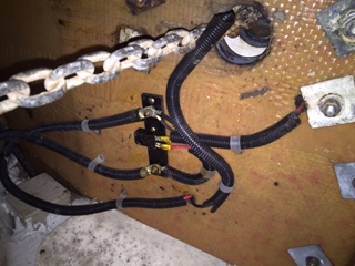

Thanks for sending that link to the wiring diagram. My 12 Meter has slightly different wiring. They bring a third small switching wire along with the larger guage wires from the battery. Note in my pic that the relay is not there. The only way this will work is if the relay is located somewhere else in the boat and the third wire comes from the foot switch to pull in that relay. Does anyone know where they locate the relay? I don't want to pull the boat apart to find it if someone actually knows where Trojan put it.

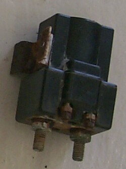

Hi,
I found what the solenoid looks like. Does this picture jar anyone's memory if they have seen this around their International boat?
- Sea Wolf 520 Solenoid.jpg (14.65 KiB) Viewed 16092 times

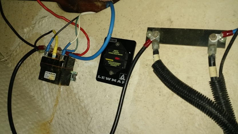

My 12m has a Lewmar, but the setup in the anchor locker should be similar. I haven't run mine yet, so I may be replacing the solenoid and adding wireless anyway.

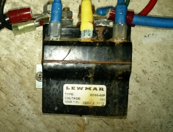

Re: SeaWolf Windlass 520

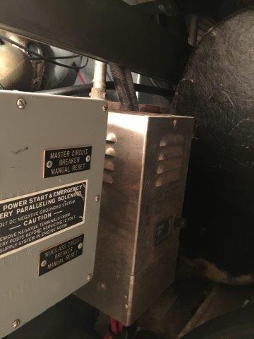

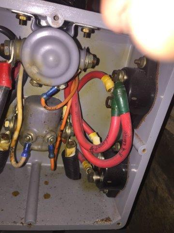

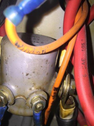

Found it! Well thanks to some electrical drawings Bob sent me I found the solenoid. Hiding in plain sight. It's behind the starboard motor next to the battery charger. Need to get behind the motor and look forward to read it. The solenoid looks like the average run of the mill solenoid, not what I had seen from other website data. I have no power to it. So I think I have a bad switch in the panel. I didn't have my tester with me, so the investigation continues. You can make out the word windlass written on the wire.

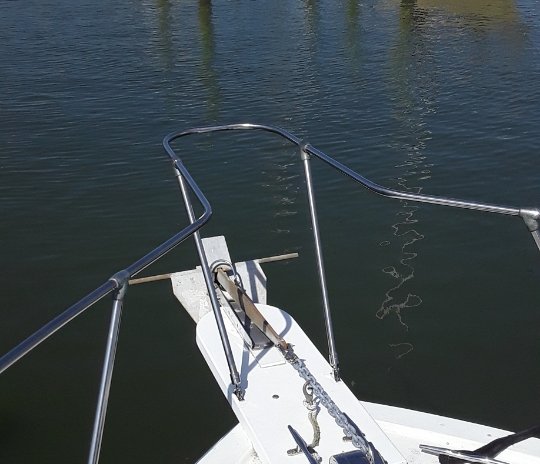

- bow rail new.jpeg (43.21 KiB) Viewed 10946 times
