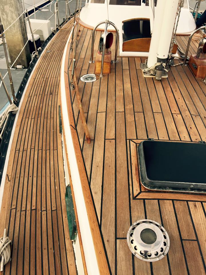

Re: Teak Deck Refinish
This is what natural teak decks should look like.

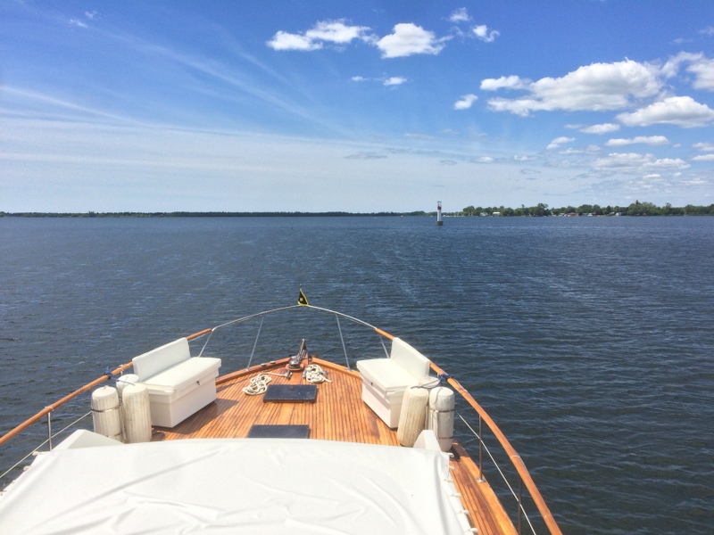

I think that my original mistake with Cetol was putting 3 coats of the gloss finish on bare wood.
My main concern for this boat is to keep the light colour of the wood (see picture attached taken in June 2015 arriving on Lake Ontario). I look in the can of Cetol and it looks like mud colour.
I was told by the original owner (John) that it is not Cetol on the decks and this was confirmed by his best friend (Arden). Neither could remember what it was. It might have been touched up with Cetol in the past 5 years as John was not able to do the work in his senior years.
However, I've got to trust your experience (and the others on this post). Luckily, it's only a few spots that the water has gotten underneath, but that is also why I want to start from clean bare wood.
As in my previous post, I'm worried about using a heat gun or chemical paint stripper since I'm afraid that they will remove the black caulking...... unless you tell me they won't. I was planning to use a paint scraper and sanding. The boat came with a belt sander and a vibrating sander, so I sorta took the hint.
