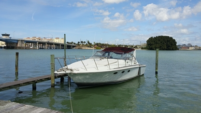

Greetings, recently purchased a 1984 Trojan international 10m express. She is now dry docked so we can work on her.
The plan: basically, bought this to be a live aboard for my fiance and me, staying at our local marina. Structurally, she is sound. Mechanically, she needs just about everthing.
Purist, please forgive us, but we are considering turning her into a strictly live aboard boat. Pulling engines and related hardware out and creating a living space in this area. Anyone ever done this? Is it difficult to remove engines? Are they worth anything whole? As parts? There seems to be 3 or 4 fiberglass structural beams about 8" high on each side of engines, we wanted to knock those down also. If she is only used to float, removing these should not be an issue correct?
Any ideas, help, appreciated.

Welcome to the site . I understand what your trying to do . But you should stop and think about it . While the 10 meter is roomy , But for 2 people to live on it gets small . So your idea is to make more room . Removing the engines fine ( can be sold )but the stringers are the strength of the hull . removing them can cause issues . Even on land and when the lift it . The other side is resale . You may not be worried about it , but come time to move you will have issues selling it like that . If fact you could end up paying a lot to dispose of it .
I would leave it as it is . if its to small as it is then sell it and look for something bigger . Like a Trojan tri- cabin . You can find them that need work not running Cheap sometimes . I know several people that bought them just to live aboard . Ton of room 2 sleeping areas , 2 heads (bathrooms ) large living area .
Sorry if I came across negative . I am just trying to be realistic .
No mater what you do I wish you luck . and we are here for any questions .
