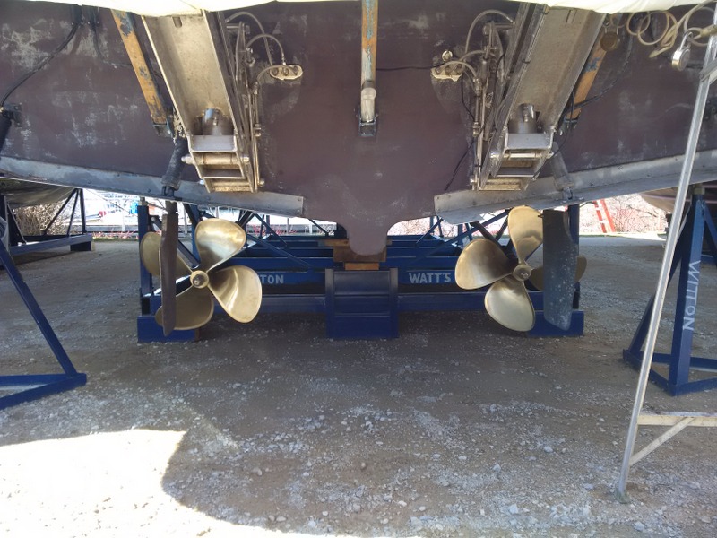

Just a clarification...... my props just arrived and they are....
Michigan Wheel DynaQuad 24" x 24" 4 blade bronze
to match what was there.

Good to go. Very pretty.
Interesting.... the smaller nut is the prop nut, the larger nut is the jamb nut and goes on last.

Nice

New props look mintRonW wrote:Good to go. Very pretty.
RonW
Is that a hydraulic swim platform?
Lets see some more pics of that please

Rather than hijack the Prop thread, I'll start a new post for the hydraulic lift.
