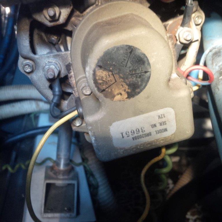

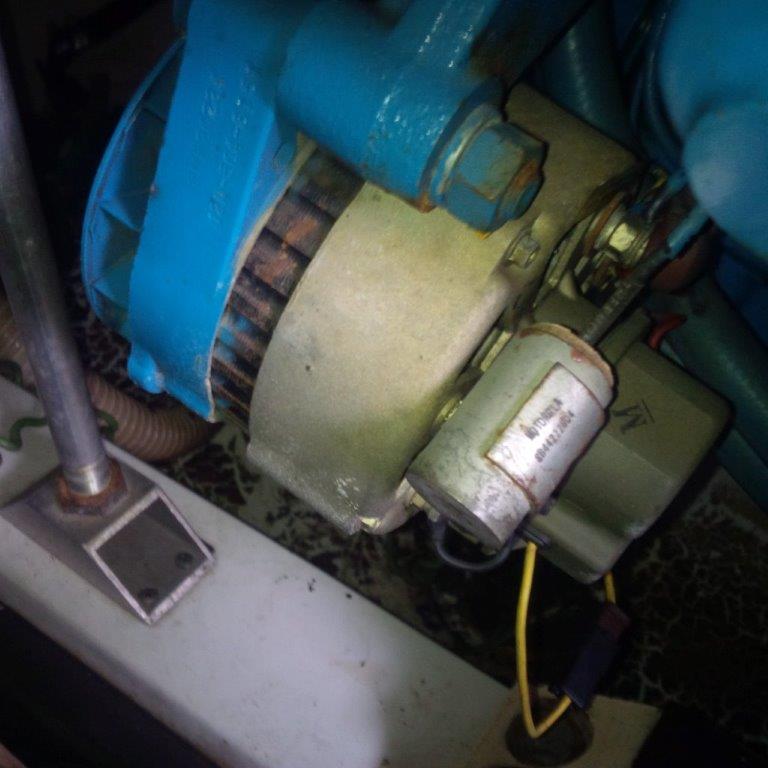

My starboard battery reads 14.2 volts. When I start the motor it drops to 12.6 volts. when i raise the RPM's a little it goes to 14.5 volts and jumps around. The first pic shows the can.

Looks like an old style can capacitor.....seems like it is all charging correctly, judging by your numbers there.....I would take the numbers off that and the alt( motorola) and visit your local alternator rebuild guy and ask him what that is for and do you really need it.....maybe that is giving you the trouble ......does the other engine have the same setup??

The "can" is a capacitor. It's function is to take the noise out that a rotating type generator will produce. Without it you risk transferring that noise into radios as a whine that changes with rpms.

Correct on the capacitor, it also is supposed to act as an electronic snubber or shock absorber for preventing exactly what you are describing. (erratic voltage). Think of it as a small battery that helps hold the correct voltages but for only short periods of time. It could be that it is failing and not so much the alternator. Most all the newer alternators have built in voltage regulators and noise suppression. That way they can sell you a new or rebuilt alternator vs repair only the less expensive bad part. Like I said earlier, voltage regulators either work, or they dont 12-14.5 or 0.. I think you are getting warmer. Not sure of the age of yours, and even if a rebuilder will have the proper parts for it. I'd sure try.
