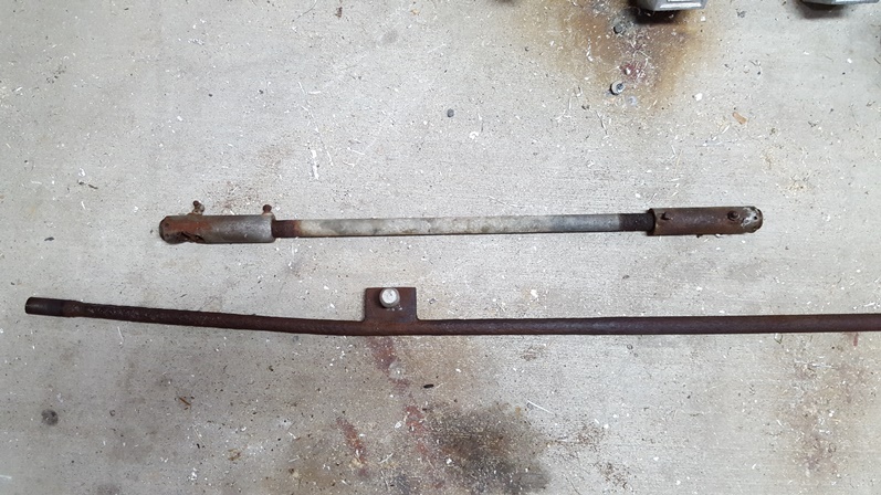

After investigation, I determined that the slop came from the linkage between the 2 rudders. the connecting shaft was so rusted that it was bending and twisting instead of synchronizing the 2 rudders. last Sunday, I dismantled the system to bring back home and work on it during the week. I was dreading the job because of the rust but in the end, I guess all the grease helped because taking the linkage off took all of 1 hour. :lol:
You can see in the picture below the state of the long connecting shaft. a good 50% was rusted out and bent out of shape :shock:
For the shorter shaft, I decided to keep it as it was not in bad shape apart for some surface rust.

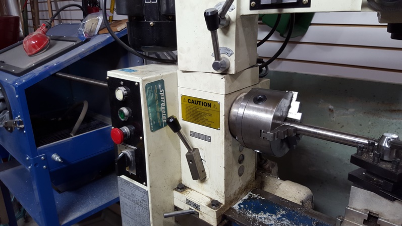

OK Plan "B" I am lucky to own a lathe and a milling machine. I'll just have to make it from scratch. I went to Metal Supermarket and got a length of 15/16" 316 Stainless Steel. For our American friends and others, Metal Supermarket supplies small quantities of raw material. Perfect for the hobbyist 8) .
Space is a bit limited in my garage! with the lathe and the sand blasting cabinet close together, I had to be creative with the shaft going through the headstock straight through the blasting cabinet :shock:

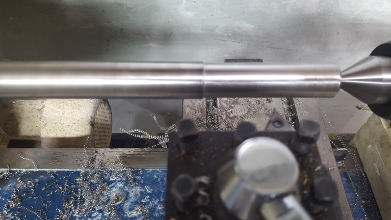

Here is a picture of the thread outside diameter.

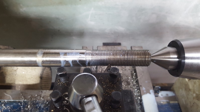

After machining the OD, I proceeded to machine the threads.

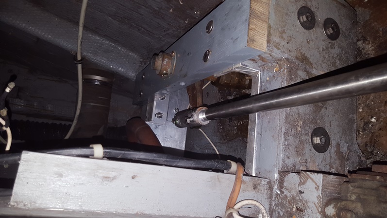

Once I was satisfied that the ball joints screwed on properly, I TIG welded the ball that connects the steering arm to the shaft. I finally cleaned the ball joints, chased the set screw threads, replaced the grease nipples and re-assembled everything using grease and anti-seize as required. Last night I finally got to the boat and re-installed everything back greasing everything liberally with a grease gun.

In this is the final result looking at the starboards side. The slop is much much better but I will have to wait for this weekend to try it out :cry:
If any of you need additional details, let me know. I will be happy to answer any question.
