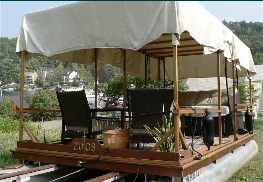

Let me rephrase the question...
This is more of an intellectual disscussion on pie in the sky ideas and solutions, while still being practical...
My main objective was not to save fuel... I just threw that out there... and BTW... I had my last boat for 9 years, a custom built pontoon boat made out of mahogany with no vinyl or aluminum anywhere except for the pontoons themselves and the frame of boat.
This new trojan is awesome for me and my wife and the lake we are on... I can't see changing for many many years, and if I do, it will be in much better shape and features than when i bought it. ($7,000 and super clean)
I have designed an electric re-power with dual electric motors and a genset that would be pretty slick, and these 318's seem to fetch a good price on the market, so the cost is not crazy...
I am looking for a great discussion on the possibilities of what could be done regardless of payback or ROI... by all you many super talented Trojan owners with what I have found to be excellent advice and ideas
