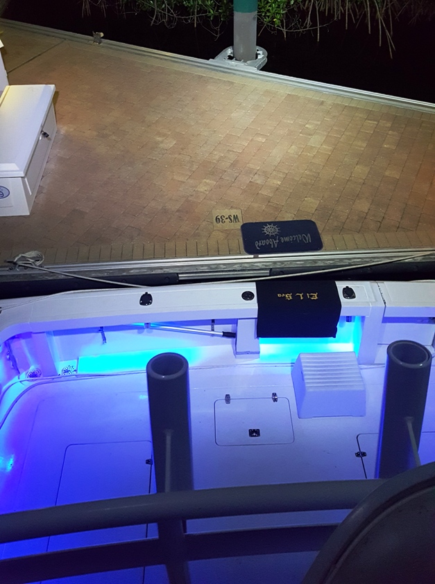

Re: 1987 10M Sedan bilge pump question
I have a hatch on top of the fuel tank. You can see it in the picture dead center below the fuel fill.
