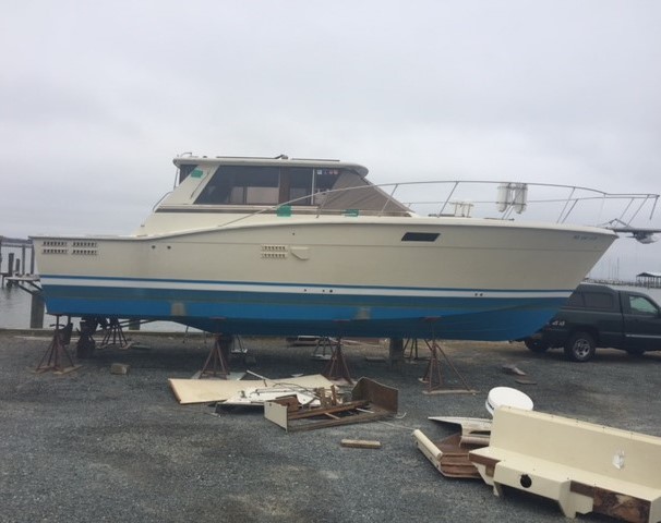

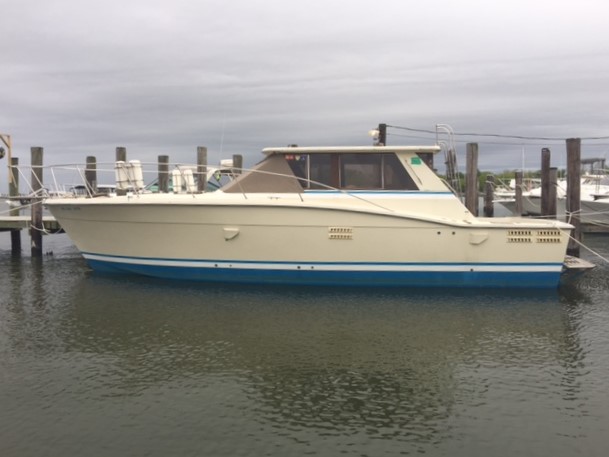

Two pics of result.
- IMG_0964 (003).jpg (73.22 KiB) Viewed 13629 times
- IMG_0909.JPG (79.22 KiB) Viewed 13629 times

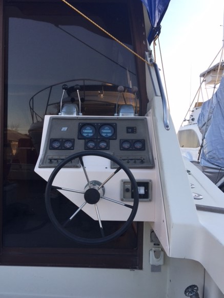

Console made for what were the bridge controls.
- IMG_0921 (2).JPG (71.81 KiB) Viewed 13629 times

Looks very nice! Having the console in the cockpit will make docking a breeze, even if single handing.
Maybe we will get to Rock Hall this summer and see her in person.
Re: Removing fly bridge
Looking good! Like the use of the upper helm. A great docking station.
