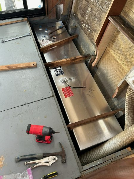

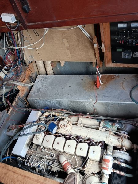

F36 fuel tank replacement
Posts: 12756

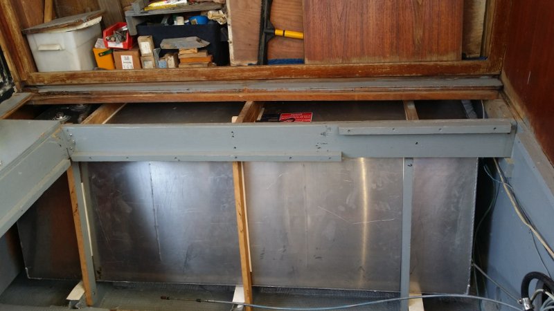

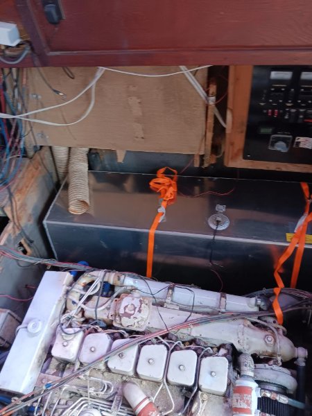

Some photos from my replacement, along with other F36s
Tank bottom.jpeg (74.14 KiB) Viewed 352 times
New fuel tank F36.jpeg (57.97 KiB) Viewed 352 times
old fuel tank.jpeg (80.12 KiB) Viewed 352 times

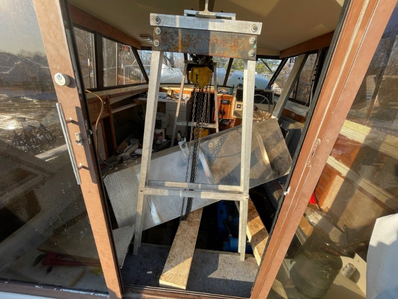

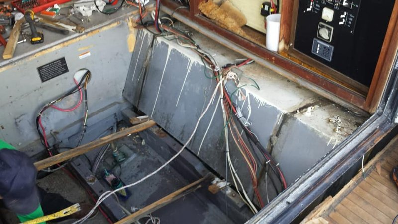

Other peoplesF36 tanks
f36 trojan tank installed.jpg (65.29 KiB) Viewed 351 times
F36 tank jeremy.jpg (112.1 KiB) Viewed 351 times
F36 fuel tank (Jay).jpg (85.79 KiB) Viewed 351 times
F36 tank.jpg (80.31 KiB) Viewed 351 times

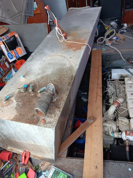

tank ( mine )
tank old.jpeg (76.49 KiB) Viewed 351 times

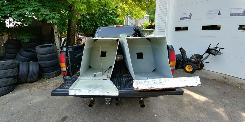

Misc.
f36 trojan tank installed.jpg (65.29 KiB) Viewed 347 times
F36 tank.jpg (80.31 KiB) Viewed 347 times
trojan tank by SP tims tank.jpg (67.91 KiB) Viewed 347 times
Re: F36 fuel tank replacement
NICE JOB!
Posts: 12756
Big D wrote: Sun Jan 11, 2026 9:14 amNICE JOB!
Thank you I should be clear that the photos are from 3 or 4 different boats. The ones that looked the best were likely not mine. I got the photos from talking to one owner for advice on replacing mine. Thank you, Jay! The photos with the white engines in them are mine. And the rest are from others who consulted with me on replacing theirs. I should have more photos from at least1 more F36. I installed mine in early 2024, and I can think of 4 others that have done theirs since most were the original tanks (Mine was not) I will post more as I locate more photos. Two key takeaways: you do not have to pull the engine ( though it can make it easier and make the new tank 2" shorter in lenght, as it makes the install easier.
On another note How have you been Big D, hope you're doing well.
