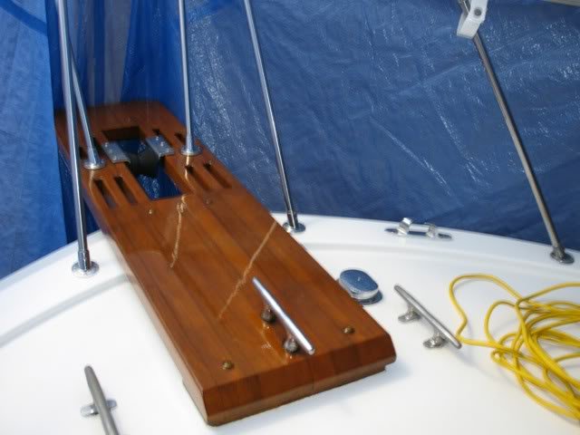

Cetol Light or Natural may give you the look you are after... This shot is Cetol Light with Cetol Gloss over top. The second one is a little fuzzy with the low light under the cover.
There is a product I used years ago that I think also had a lighter finish (may be what the prev owner had on the decks) - Deks Olje. http://www.deksolje.com/ We used it on my father's 1969 28' Sea Skiff for a few years before switching to Cetol for ease of maintenance.

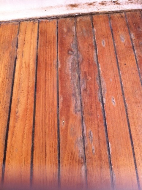

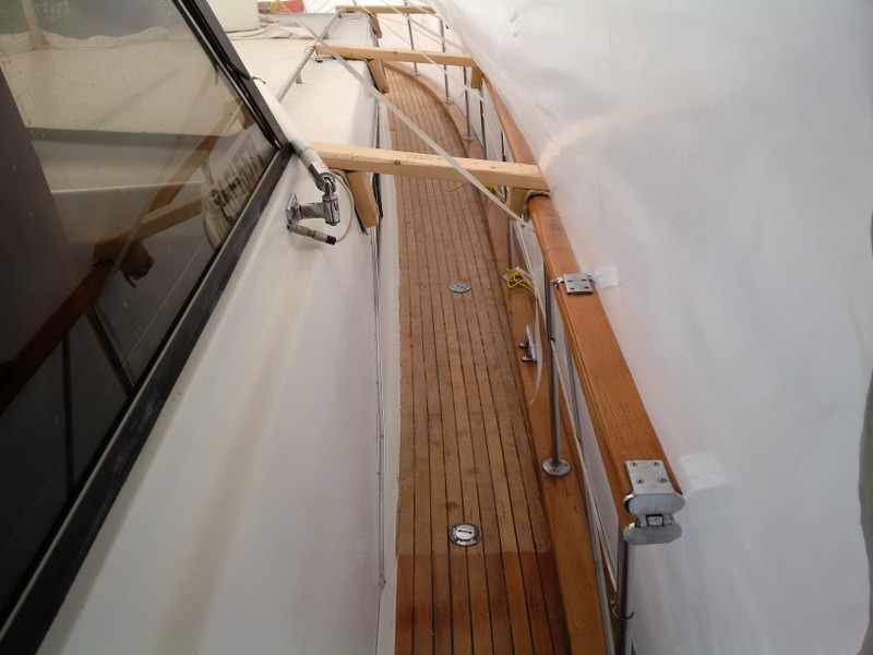

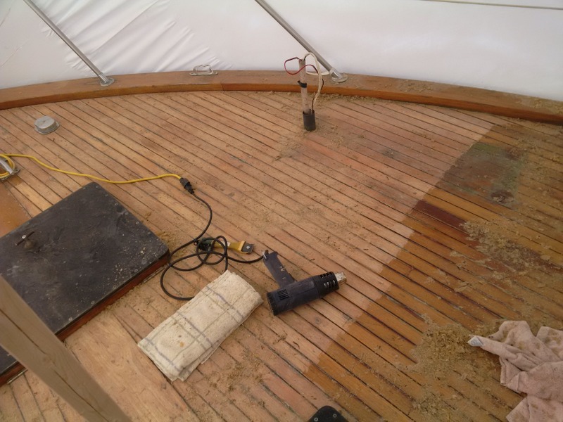

I must be the only Trojan owner with teak decks that has never refinished teak before. I'll post my progress in case anyone is interested because I haven't seen any pictures of refinishing teak that has black caulking strips. The thought of disturbing the black caulking had made me nervous.
I didn't want to use chemical stripper because I did a small area on a previous boat and it did remove the black caulking strips. I was worried about the same thing with a heat gun.
Good news, application of the heat gun until the finish just bubbles yellow, allows the surface to be scraped bare without affecting the caulking. I started with a 2.5" scraper but found the 1.5" wide better. Trouble is that you can only do about 1.5" x 2" square at a time. Extremely tedious work but very satisfying results. The foredeck took 17 hours and each side deck was 10 hours. The side decks were nasty because there is very little room to get comfortable between the shrink wrap and the glass.
Just started sanding with 100 grit on an orbital sander.
The whole reason for doing this is to get rid of the grey..... not showroom, but much better. The close-up picture, shows the grey I am trying to get rid of on the right, and the sanded wood on the left.
As per all the advice (above) and am planning to use Cetol Marine Light.
Couldn't snowmobile all winter due to lack of snow and here I am refinishing the deck with snow predicted this Sunday (April 3).
Ron

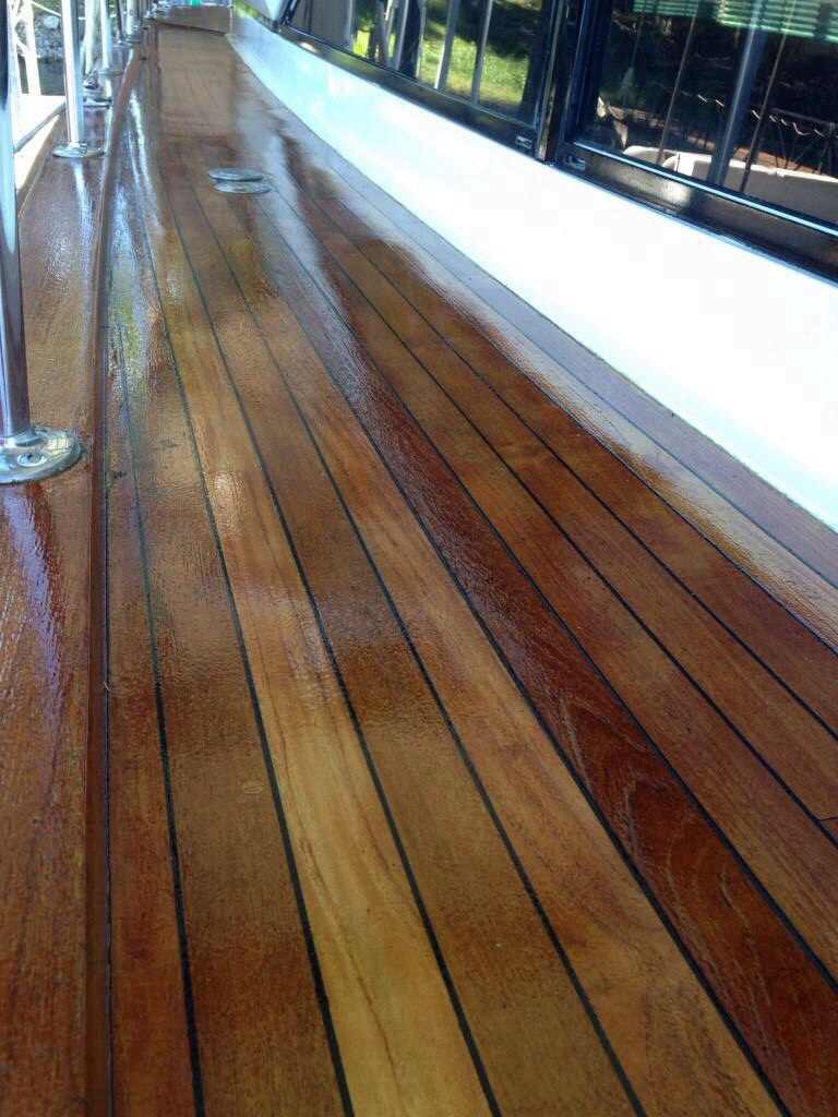

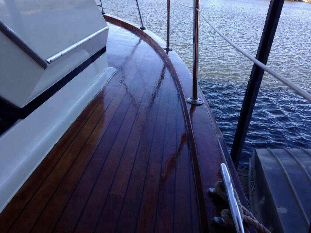

If I could figure out how to resize pics I would post some of the deck refinish and other projects I've been working on.
dockedwages1
- Posts: 26
- Joined: Tue Sep 04, 2007 11:30 pm
- Location: St. Louis
Re: Teak Deck Refinish
Let me see if I can get this to work.
- image.jpg (156.82 KiB) Viewed 13185 times
I think you may have seen these pics. Trying to get the ones I have of sanded wood.

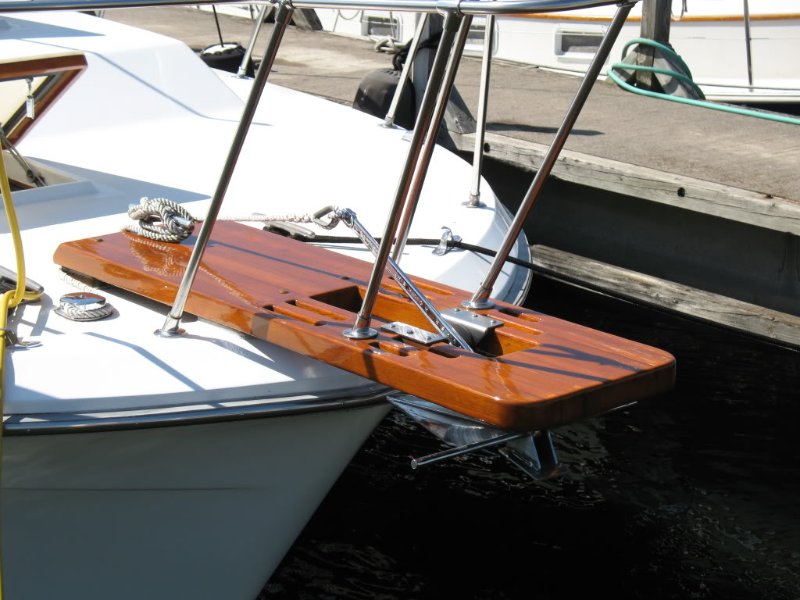

Thanks for the pictures guys. The number of blue beer cups looks about right for this kind of work.
I like the look of Dockedwages deck, although I expect mine will come out lighter (which I like as well). It looks high gloss which I was told not to do since it will be too slippery...... or is that natural Cetol.
Also, what caulking should I use along the cabin-to-deck seam (as shown in Dockedwages deck pictures). Do I caulk to the bare wood (I assume) or after the Cetol (to which I wouldn't expect it to stick).
